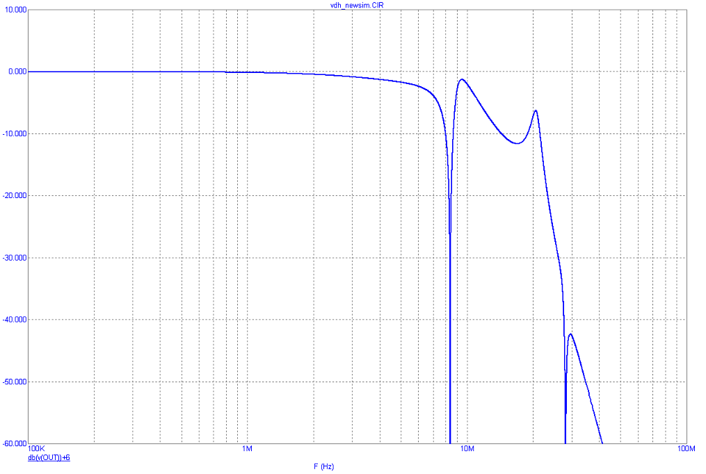

VDH kabel - simulace:
 Filesize:  84.49 KB
 Viewed:  707 Time(s)
