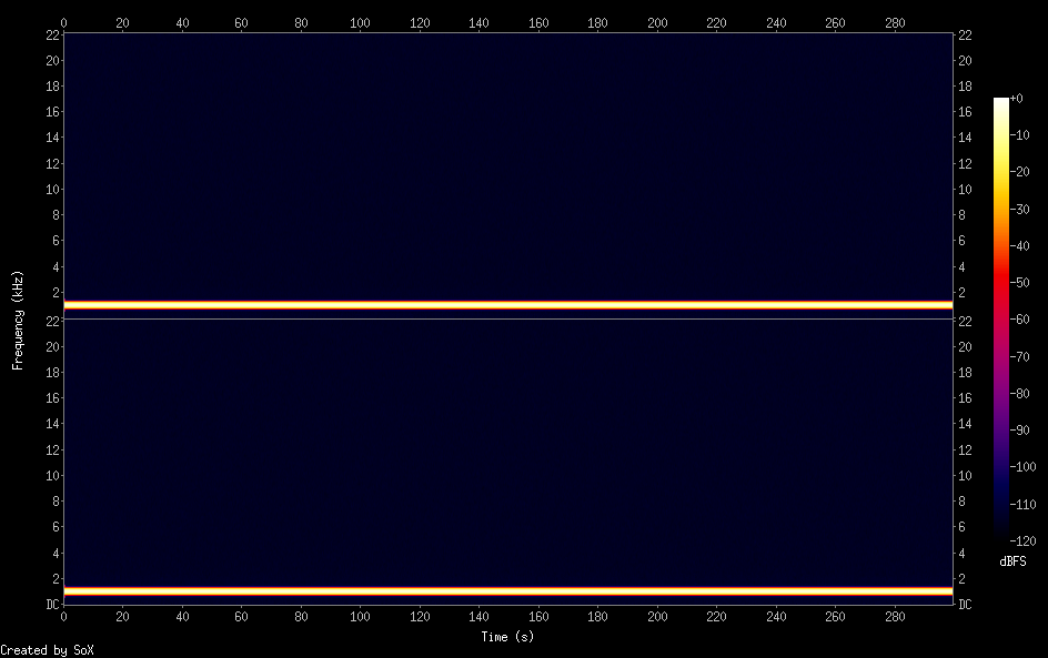

Pět minut sinusu 1kHz -3dB stereo 44,1kHz ditherovaný do 16 bitů uložený do sine-441-16.wav:
kód:
sox -V  -r 44100 -c 2 -s -b 16 -n  synth 5:00 sine 1000 vol -3dB
sox: SoX v14.3.0
Input File     : '' (null)
Channels       : 2
Sample Rate    : 44100
Precision      : 16-bit
Sample Encoding: 16-bit Signed Integer PCM
Endian Type    : little
Reverse Nibbles: no
Reverse Bits   : no
Output File    : 'sine-441-16.wav'
Channels       : 2
Sample Rate    : 44100
Precision      : 16-bit
Reverse Nibbles: no
Reverse Bits   : no
Comment        : 'Processed by SoX'
sox INFO sox: effects chain: input      44100Hz 2 channels
sox INFO sox: effects chain: synth      44100Hz 2 channels
sox INFO sox: effects chain: vol        44100Hz 2 channels
sox INFO sox: effects chain: dither     44100Hz 2 channels
sox INFO sox: effects chain: output     44100Hz 2 channels
Kontrolní spektrogram uložený do spectrum.png:
kód:
sox: SoX v14.3.0
sox INFO formats: detected file format type `wav'
Input File     : 'sine-441-16.wav'
Channels       : 2
Sample Rate    : 44100
Precision      : 16-bit
Duration       : 00:05:00.00 = 13230000 samples = 22500 CDDA sectors
File Size      : 52.9M
Bit Rate       : 1.41M
Reverse Nibbles: no
Reverse Bits   : no
Output File    : '' (null)
Channels       : 2
Sample Rate    : 44100
Precision      : 16-bit
sox INFO spectrogram: actual pixels/s = 2.67435
sox INFO sox: effects chain: spectrogram 44100Hz 2 channels
sox INFO spectrogram: PNG truncated at 299.138 seconds
 Filesize:  135.64 KB
