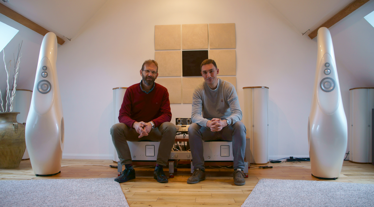

PríspevokZaslal: Ut máj 09, 2017 19:58:23    Predmet: Odpovedať s citátom
http://www.6moons.com/audioreviews2/vivid/7.png
https://www.focal.com/en/position-hifi-stereo-speakers
http://bowersandwilkins.custhelp.com/app/answers/detail/a_id/1935/~/where-should-i-place-speakers-for-my-bowers-%26-wilkins-home-cinema-surround
http://www.psbspeakers.com/articles/Speaker-Placement-Tips-for-Real-Sound
http://www.uaudio.com/blog/studio-monitor-placement/
