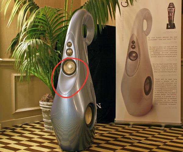

Tie fora...
Toolemu sa uplne nezda ani meranie Vivid G2 z NRC:
- https://www.soundstagenetwork.com/index.php?option=com_content&view=article&id=685:nrc-measurements-vivid-audio-giya-g2-loudspeakers&catid=77&Itemid=153
The Giya has a persistent low-Q energy hump around 500-1000 Hz again as seen in far off-axis curves.
Zdroj: https://www.avsforum.com/forum/89-speakers/3038828-how-choose-loudspeaker-what-science-shows-62.html#post57632446
Dr. Toole, a question: When referring to the Giya. Isn't the low Q hump merely a side effect of the side firing woofers?
It may or may not be, but whatever the cause, it should not be there. Woofers operating up to those frequencies would be an odd decision.
Zdroj: https://www.avsforum.com/forum/89-speakers/3038828-how-choose-loudspeaker-what-science-shows-62.html#post57633778

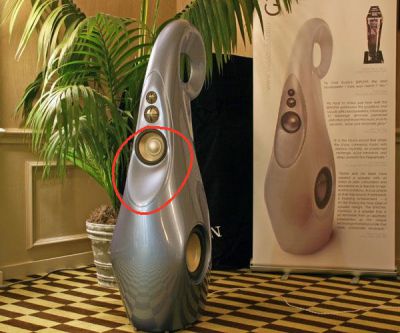

miero napísal:
Tie fora...
Myslím, že vo vyznačenom mieste by mohlo dochádzať ku odrazom v danej frekv. oblasti mimo osu.
M.
 Filesize:  67.3 KB
 Viewed:  57 Time(s)
Príspevky: 12783
PríspevokZaslal: Po august 26, 2019 11:46:02    Predmet: Odpovedať s citátom
Tam to vypadá jako ne úplně hladké navázání basáků na střeďák. Holt to uspořádání má i svoje nevýhody.
