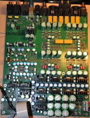

PríspevokZaslal: Ne október 24, 2010 09:41:29    Predmet: RE: HODNOTA JITTER Odpovedať s citátom
sorry, nenašiel som nikde. Ale našiel som fotku PCB
ďalšie info:
"which chip?
We're using TAS1020B controller which is an 8051 MCU core coupled with Full Speed USB 2.0 compliant device, I2S interface and programmable PLL clock generator. It forms an integral part of the product - we use it for general housekeeping on the main board, not just for USB Audio duties. We chose this chip because it's relatively inexpensive and has all the necessary bits in place.
what software?
The chip is general purpose and without software it would be just sitting there doing nothing (OK, waiting for firmware upload to be precise). The firmware is my own work and implements Asynchronous Isochronous streaming of up to 24b/96k in accordance with USB Audio Class v1.0 specification which is supported by all major operating systems out-of-the-box. That means we're plug'n'play - no need to install any drivers.
why only 24/96?
This is limited by the 12Mbps Full-Speed USB where the maximum amount of data transfered in isochronous mode is 1023B per USB frame which lasts 1ms. That means maximum 1023000B/s. 24/96 data requires 576000B/s. If we look at the next step which would be 24/176.4 it is already more (by a fraction) than we can handle with 1058400B/s - that's why anything above 24/96 is a no-go for 12Mbps Full Speed USB and requires the 480Mbps High Speed USB.
However High Speed USB is a 'bag of hurt', to borrow Steve J's words. First of all, his operating system is the only one supporting USB Audio 2.0 out-of-the-box. Windows boxes require installing driver. The other problem is finding a suitable chip. Inevitably any such solution will end up costing significantly more and won't be as convenient for majority of customers (still on Windows).
There is absolutely no need for Super Speed USB 3.0 for audio purposes whatsoever - High Speed USB 2.0 can easily handle at least 8 times the traffic for isochronous pipe (High Speed USB has microframe lasting 125us) - good enough for 10ch at 32b/192k!
architecture?
The master clock in our product is a discrete low phase noise oscillator of our own design running at 84.672MHz (1920fs at 44.1) and it sits right at the DAC. We are dividing down from this clock to feed both the CD servo and USB chip. USB also requires a 12MHz related clock for the bus transceiver which is a frequency unrelated to audio clock, therefore we run a PLL to derive the USB bus clock from our audio clock. When streaming at 44.1k or 88.2k the USB interface is 'Clock Locked' to the DAC in exactly the same way the CD transport is. There is no ASRC going on, everything is fully synchronous. When streaming at 48k or 96k we use a PLL to generate a fixed frequency for audio interface to which the computer is slaved. In this case we use the ASRC built into the DAC chip to bridge the two frequency domains (44.1/4Cool. Since all clocks are derived from a single source - the DAC master clock - they track perfectly together and there is no low frequency deviation between them, so that the ASRC operating with low corner frequency finds an extremely stable ratio that does not drift.
benefit of asynchronous?
To anybody involved with audio engineering it must be absolutely clear. Asynchronous USB Audio is like a 'Clock Locked' CD transport and unlike an S/PDIF or Adaptive/Synchronous USB Audio. There is no perfect jitter rejection in this world and therefore the way to get the best results is not having to perform any! For that, the DAC has to be the one governing the rate of incoming data as opposed to having to adjust to it.
The Audiolab units have a couple nice extra features such as HID media control where you can skip tracks, play, pause etc. in your media player using the remote control. Another useful and unique feature is a real-time display of not only sampling rate but also actual bit depth of the audio stream. When you're playing lossless CD the display should read 16bit/44.1k - if it doesn't, you instantly know you're not bit perfect and should do something about it - see manual. Play an HDCD with a proper decoder in foobar and you'll see 17bit/44.1k. Use DirectSound through the infamous kmixer.sys and you'll see 24bit/44.1k as there's a low level dither applied on the way through kmixer."
