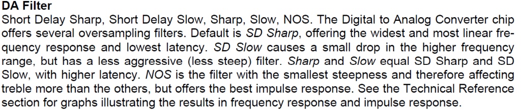

Mala by to byt moznost "NOS-Non-Oversampling":
 Filesize:  127.74 KB
 Viewed:  529 Time(s)

Viď môj predchodzí príspevok. Zároveň sa tam píše "...NOS is the filter...".

Toto je uvedene v pdf priamo k DAC cipu:
SSLOW: Super Slow Roll Off (Digital Filter bypass mode) or Low Dispersion Filter Enable. (Table 25)
