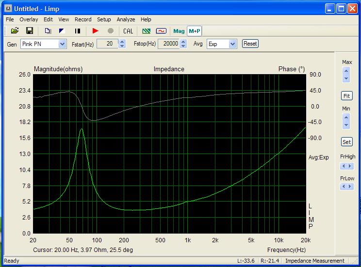

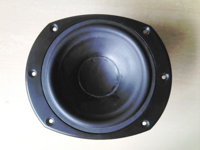

Zdravim, uz davnejsie sa mi podarilo ziskat 2 basove menice z kvlitnych bedniciek Tannoy mercury M1. Preto by som s tymito menicmi rad zrealizoval svoje nove bednicky. Menice niesu najnovsie, su trochu osuchane, ale funkcne su uplne OK. Podarilo sa mi aj pomocou jednoducheho merania a programiku Limp v Arte zmerat TS parametre a impednacne krivky basacikov, no neviem co s tym dalej. Kto by mi vedel akokolvek poradit, aky vyskac, vyhybku pripadne ozvucnicu zvolit, tak by som bol velmi vdacny. dik Smile
parametre:
Fs, 67.16, Hz
Re, 3.20, ohms[dc]
Le, 735.2, uH
L2, 390.23, uH
R2, 7.40, ohms
Qt, 0.57, -
Qes, 0.70, -
Qms, 2.99, -
Mms, 10.02, grams
Rms, 1.412291, kg/s
Cms, 0.000560, m/N
Vas, 7.11, liters
Sd, 95.03, cm^2
Bl, 4.385718, Tm
ETA, 0.29, %
Lp(2.83V/1m), 90.77, dB
 Filesize:  24 KB
 Viewed:  583 Time(s)
 Filesize:  31.01 KB
 Viewed:  537 Time(s)
 Filesize:  74.43 KB
 Viewed:  572 Time(s)
