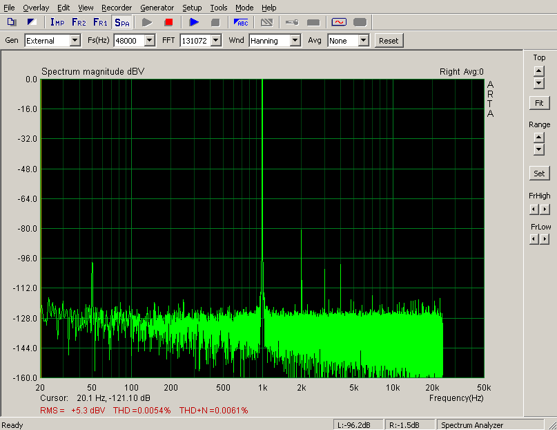

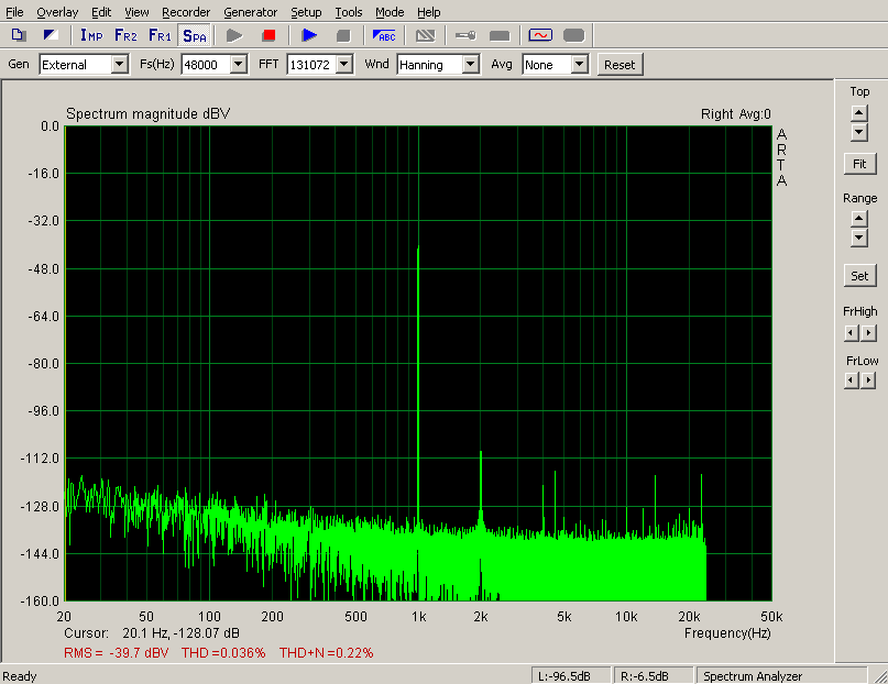

Za polovicnu cenu Dragonfly ide z Ciny kupit i tuto srandu, avsak s horsim zvukom nez ODAC+O2.
http://hifimediy.com/usb-dac2
Pripajam orientacne merane bez zataze.
 Filesize:  23.93 KB
 Viewed:  234 Time(s)
