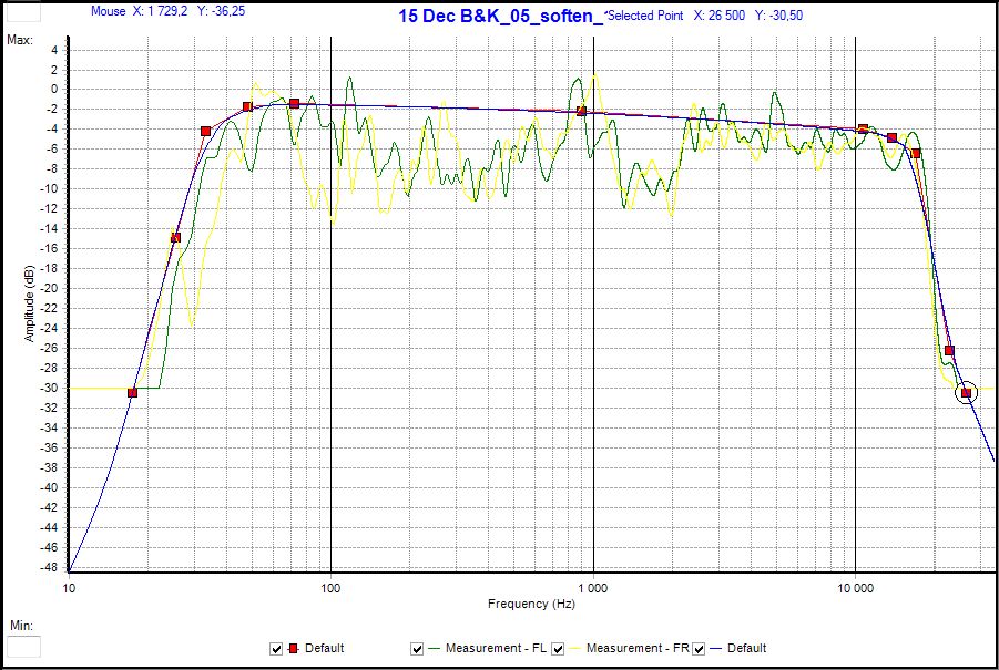

Po precitani tohto blogu http://www.computeraudiophile.com/blogs/mitchco/what-tone-quality-your-audiophile-system-126/ som sa trosku pohral s targetom a musim uplne suhlasit s autorovym tvrdenim:
''Well, the frequency response of your sound system at the listening position not only describes tonal quality (or timbre) but also directly correlates to the sound stage presented at the listening position. This is an important concept to understand. For example if there is too much high frequency arriving at the listening position, not only is it a bit bright sounding or at the frequency extreme more "air", it correlates to the soundstage being "upfront" or too forward or lacking depth. Conversely, if the high frequency roll off (or slope or shelf) is too much, then not only does it sound "dull" but the soundstage is too far back or "distant".''
J.River -> Wireworld USB -> M2Tech Young DAC -> Nordost Heimdall -> Myryad Mi 120 -> Nordost Red Dawn -> Zingali Prelude

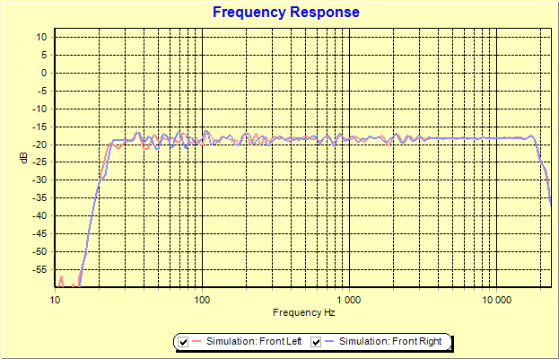

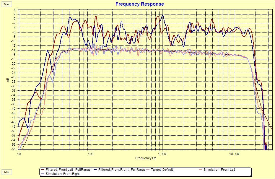

1) tonalita sa moc nezmeni, co je asi dane tym, ze Zingali horny maju velmi velky uhol vyzarovania, scena sa trosku stlaca na lavu/pravu stranu... ale nejake velke testy som nerobil, predsa si to len ladim na svoje posluchove miesto.
2) to je skor otazka na autora softveru. viem len, ze u velkych prepadov 25dB uz frekvencnu charakteristiku uplne nevyrovna. Tento priklad: http://screencast.com/t/4FOv0AKsy Pravdepodobne je prednastaveny max boost na 20dB.
U mna je maximalny prepad 15dB (filtrovane na 1/6 oktavy) a po aplikovani filtra v convolution ubytok cca 10dB (vypnuty normalize filter volume v JRiver)
