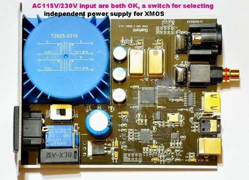

3) USB to SPDIF Converter: Gowe® U10 vs. Gustard U10
Gowe® U10 Xmos 32bit 384K USB to SPDIF Converter za $500
http://www.amazon.com/Gowe%C2%AE-32bit-SPDIF-Converter-Inside/dp/B00HUKN366
Gustard U10 za $130
http://www.aliexpress.com/item/Gustard-U10-Xmos-32bit-384K-USB-to-SPDIF-Converter-0-1ppm-TCXO-with-PSU-Inside/1497918775.html
Stranka Gowe® U10 na amazon.com dokonca obsahuje presne ten isty obrazok, ako Gustard U10 na aliexpress:
http://najlepszeodtwarzacze.pl/Gustard_U10.php
