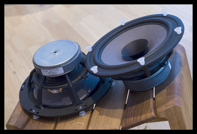

Retro look jsou prave treba ty Seas FA22RCZ:
FA22RCZ
 Filesize:  149.48 KB
 Viewed:  459 Time(s)
